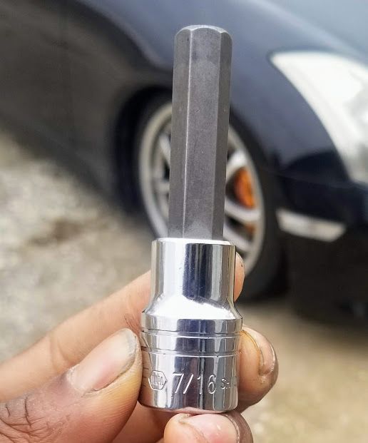

My only complain with the Z1 kit was the weird size hex bolt size used to mount the bracket to the knuckle. I could not find it at any of the local automotive/ hardware stores. It is a 7/16th size and I finally found it after two days of searching and calling around
URL=https://s1380.photobucket.com/user/seanphelps/media/20190307_092147_zpsowbwyh4g.jpg.html][/URL]
My only warning about the upgrade as a whole is be carful with tighting the banjo bolt into the caliper. These aluminum calipers are soft and it wouldn't take much to either strip the threads or snap the head off of the bolt.
